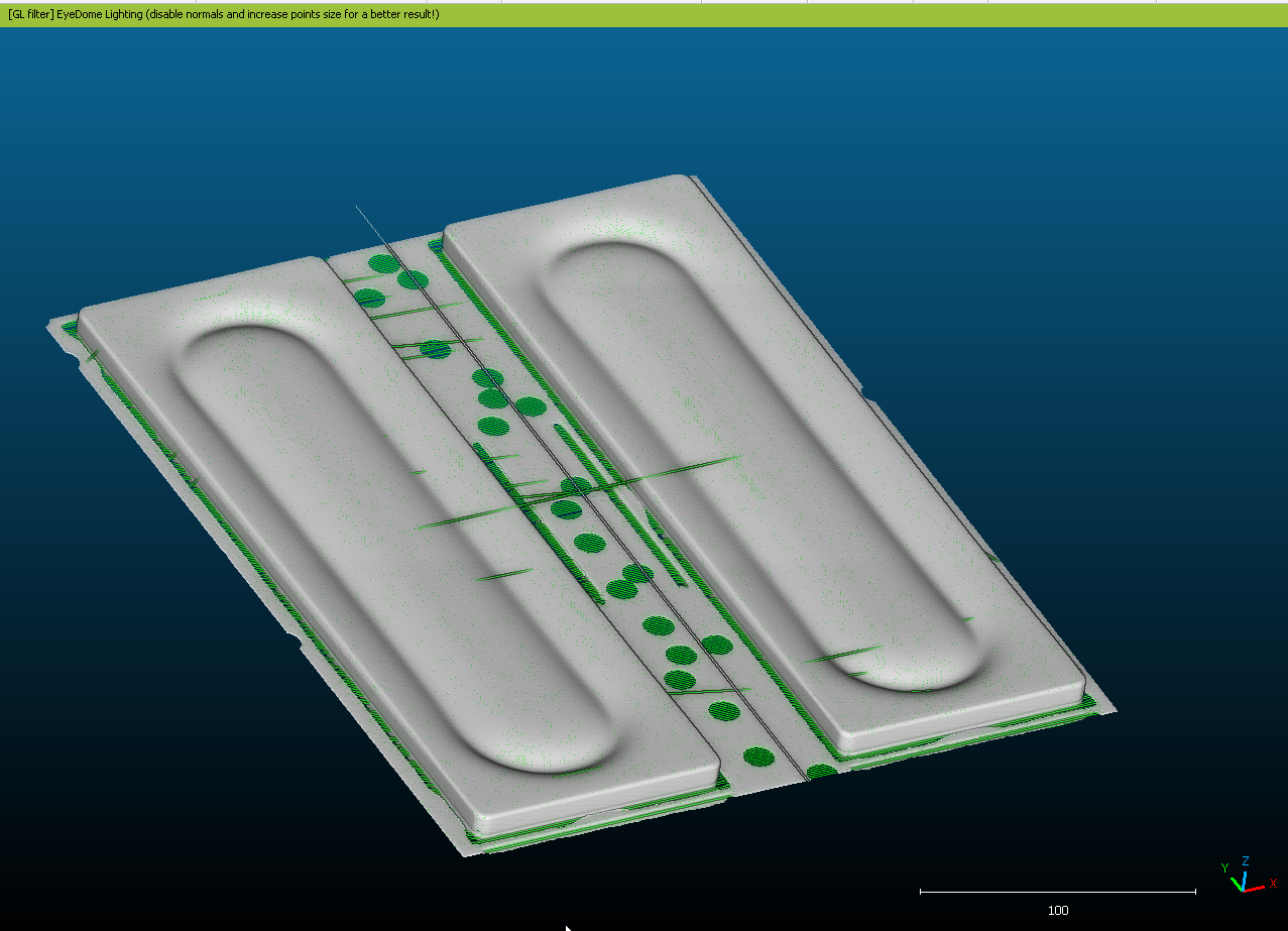

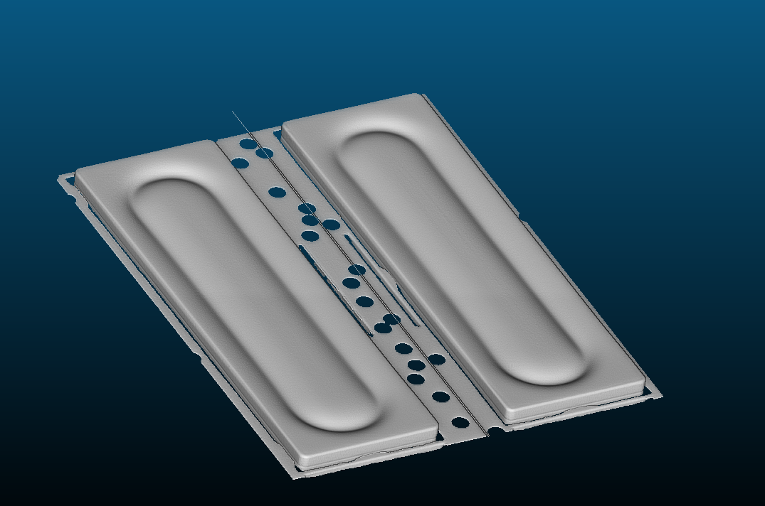

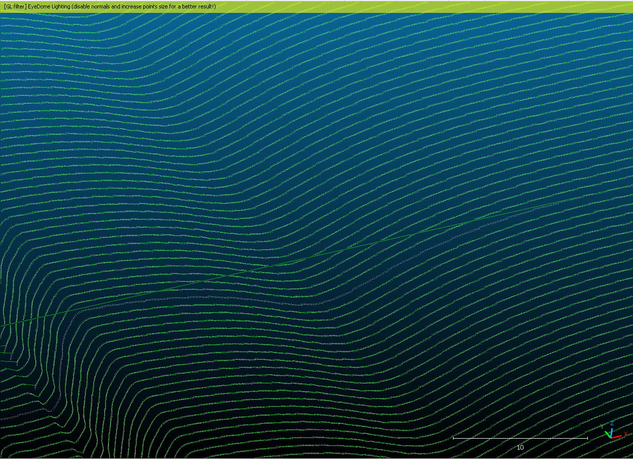

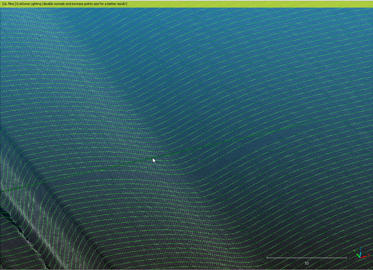

I simply can't understand why I get straight lines across a point cloud i´ve scanned.
I must be doing something wrong, I can't get the "Extract Sections along polylines" tool to work properly.
The extract tool is apparently not using the points from the pointcloud sometimes. It can be seen from the extracted cloud sections that the lines does not follow sometimes.
Can someone help me?
Thanks in advance.
Here is a linke of the Cloudcompare BIN file from my Onedrive. 200MB
https://lmtechnology-my.sharepoint.com/ ... g?e=vkFY1B

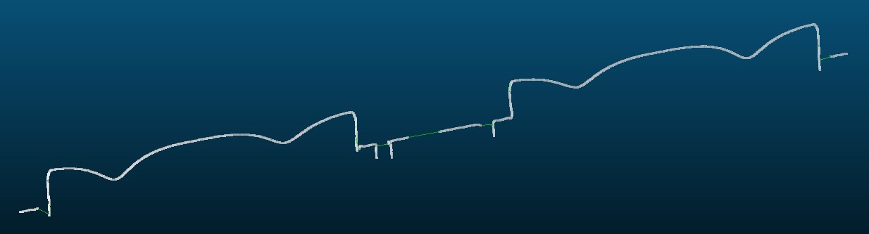

Indeed, it seems the algorithm that extracts the concave envelope fails to reach some bumps... Not sure to know why though. This algorithm is very tricky.
screenshot_2025-02-13 211732.jpg (29.82 KiB) Viewed 6329 times
While it works well on the next slice:
screenshot_2025-02-13 212225.jpg (25.03 KiB) Viewed 6327 times
