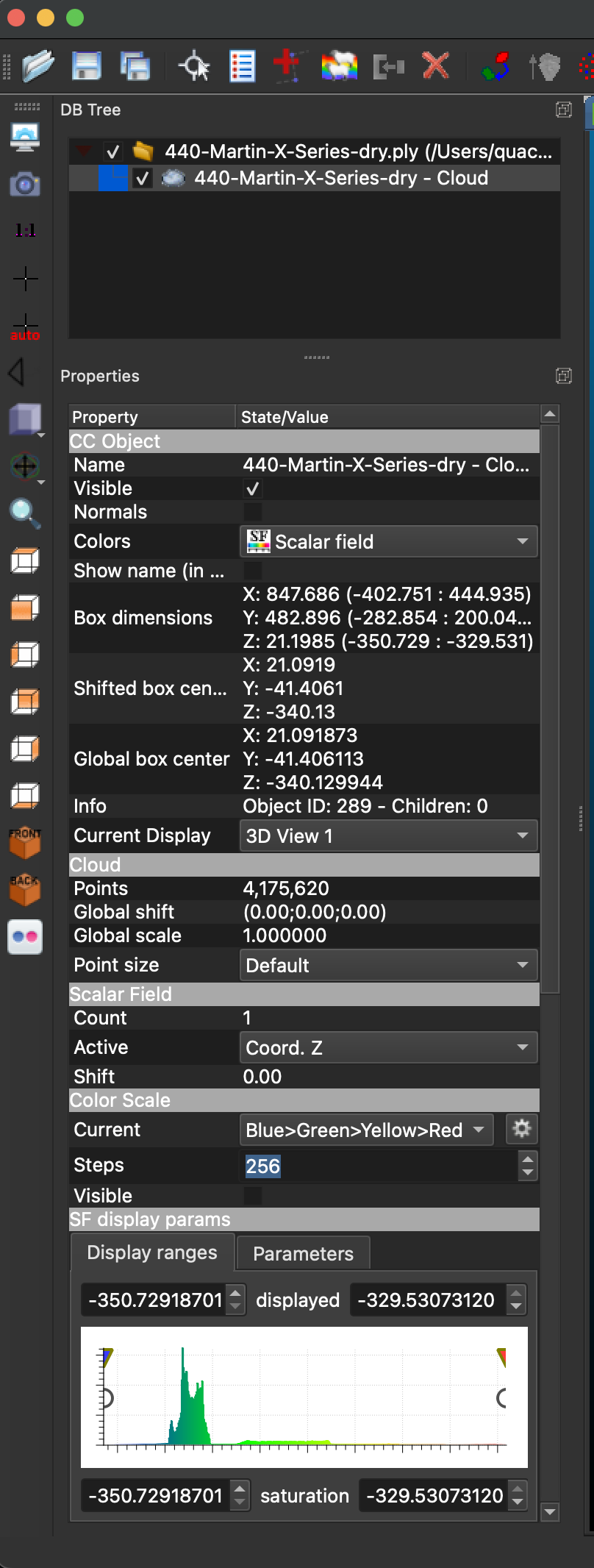

Hi all,
For whatever reason whenever I open a saved .bin file my properties no longer show up with the usual complete list of properties. What I see is this.
Screenshot 2025-04-19 at 9.45.49 PM.png (298.55 KiB) Viewed 1158 times
But when I open a .ply file I see a full list of properties, like this.
Screenshot 2025-04-19 at 9.46.41 PM.png (189.16 KiB) Viewed 1158 times
This happened all the sudden. It used to always shop up with a full list of properties, but I can't figure out how to make it work again.
Any help would be greatly appreciated.
Thanks.
Posts: 7947
Re: Properties Not Showing up Fully
In your second example, it's the folder/group entity that is selected. Not the clouds or meshes inside the group. Hence the fact that you don't see a lot of properties...
